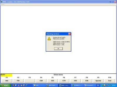

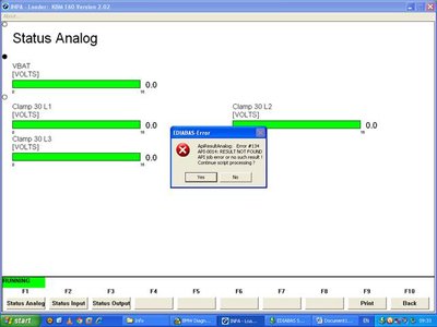

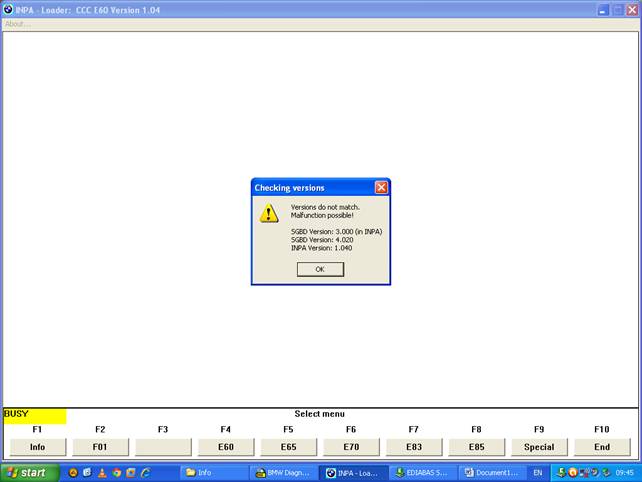

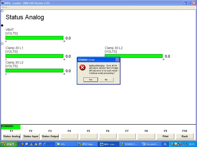

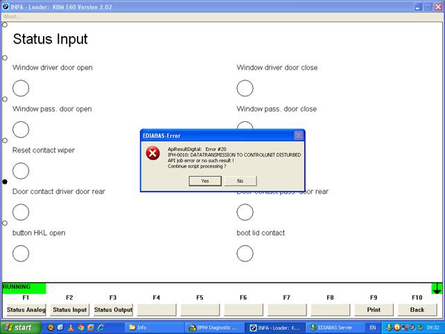

StandartinėParašytas: 28 Kov 2013, 14:34
2006.02.12
362
gal galite paaiskinti ko cia kompas arba inpa pyksta:
clip_image002.jpg [ 36.45 KiB | Peržiūrėta 15107 kartus(ų) ]
clip_image002.jpg [ 26.93 KiB | Peržiūrėta 15107 kartus(ų) ]
clip_image002.jpg [ 34.38 KiB | Peržiūrėta 15107 kartus(ų) ]

Mariuss rašė:
1. IFH-0010: DATATRANSMISSION TOCONTROLUNIT DISTURBED EDIABAS_IFH_0010Meaning: The data transmission between the interface and theECU is disturbed.Causes: Disturbance on the diagnostic line.The interface EDIC is not loaded with the diagnosticsprotocol requested in the ECU description file (SGBD).Error correction: Repeat the last job.Download the required EDIC firmware.Target system: WIN SCO QNX
2.Nekreipi demesio (del to vaiku bus) jei labai rekes paaiskinsiu.
3.API-0014: RESULT NOT FOUND EDIABAS_API_0014Error interrogating a result.Causes: The result requested from the application program wasnot returned in the required result record by the job.Error correction: Add result in the result record.If applicable, contact the developer of the applicationprogram.Target system: WIN SCO QNX
P.S. Paruosk programa normaliam darbui.....skaityk manualus....poto sekantis zingsnis , tikrinsi interfeisa :)
