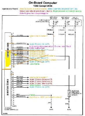

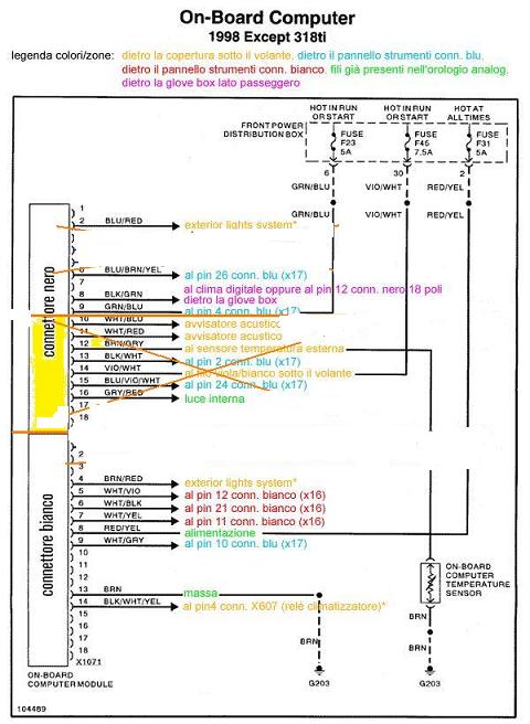

Gerb.Moderatoriai prausau isimkit pacia pirma sios temos nuotrauka su obc schema ji turi klaidu.Nusibodo kovot pries vejo malunus.Idedu 2 schemas kurios yra 100% teisingos ir klausimu turetu nebelikt.Prasau nekreipt demesio i uzbraukima shemoje.Sia dvi schemas pasitelkus i pagalba obc pasijungia ir veikia ismeginta n atveju jau..Visos slaptos funkcijos veikia ir t..t.Taip pat sios schemos tinka perdarant obc is 7 mygtuku i 18.(reikia prijungti tik kelis laidus).Sekmes visiem darbuose, tikiuosi pagelbes. :wink:
schema_elet_obc_1.gif [ 27.48 KiB | Peržiūrėta 21965 kartus(ų) ]
obc schema.JPG [ 55.65 KiB | Peržiūrėta 21705 kartus(ų) ]

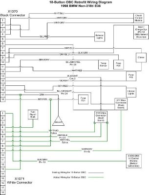

Įdedu OBC pajungimo schemą, iš 11 į 18 mygtukų, bei trumpą aprašymą.
Gal kam pravers. Pačiam teko ją išbandyti, pajungus viskas veikia puikiai.
Info ir pati schema paimta iš čia.
1. Remove old OBC, Steering Wheel, Instrument Cluster, and dashboard.
2. Remove the two connectors from the back of the Instrument Cluster.
3. Tap a fresh wire into the white/gray (WHT/GRY) wire on Pin 10 of connector X17 and run it to the white/gray wire coming out of Pin 9 of X1071.
4. Tap a fresh wire into the white/violet (WHT/VIO) wire on X16 and run it to the white/violet wire coming out of Pin 5 of X1071. Tap a fresh wire into the white/yellow (WHT/YEL) wire on X16 and run it to the white/yellow wire coming out of Pin 7 of X1071.
5. Remove the X16 connector cover to reveal the metal pins of the connector. You must figure out a way to install a new pin into the vacant Pin 21 slot. I went to the local BMW dealership and browsed their connector bins until I found a male pin connector that I could modify to work. I soldiered a fresh wire onto the pin and set the pin into the vacant Pin 21 slot in the X16 connector. I then ran this new wire to the white/black wire coming out of Pin 6 of X1071.
6. Find the ZKE IV Control Module behind the glove box. The Bentley manual will help you find it. Fabricate a pin to fit into the vacant Pin 15 of this connector. I fabricated this pin from a blue Butt Connector. Run a fresh wire from Pin 15 of the ZKE IV to the black/green (BLK/GRN) wire coming out of Pin 1 of X1071.
7. Install the turn signal stalk. Tap into the brown/red wire of the new turn signal stalk and run it to the brown/red wire of Pin 4 of X1071.
8. Tap into the brown (BRN) wire coming from Pin 17 of connector X1070 and run it to the brown wire of Pin 13 of X1071.
9. Tap into the red/yellow (RED/YEL) wire of Pin 18 of X1070 and run it to the red/yellow wire of Pin 8 of X1071.
White/Gray wire: connects OBC to speedometer sensor
White/Violet and White/Yellow wires: connects OBC to data link system. This system integrates most of the electronic boxes such as ABS, Cruise Control, EWS, ZKE, DME, OBC, etc.
White/black wire: connects OBC to gas gauge
Black/Green: connects OBC to AWS anti-theft device
Brown/Red: grounds OBC for turn signal stalk activated menu display
Brown: Ground
Red/Yellow: Power
OBC 18.JPG [ 56.47 KiB | Peržiūrėta 21287 kartus(ų) ]

bandau pasijungi 18 mygtuku obc, reikia pajungti is baltos obc fiskes i balta spidometro fiske laidus, bet pas mane jau yra spidometro fiskej tie pinai i kuriuos reikia jungti uzimti. Tai ka man juos nukirpti ir sujungti tiesiai su obc???? Ar tiesiog prie spidometro tu laidu ju nenukerpant dajungti tuos is obc baltos????
Pagal schema kur jungti tuos likusius obc baltos fiskes laidus pvz kaip exterior lights system.
Ar jus tiesiog palik nepajungtus?

Dalius. rašė:
Tai iš skydelio atitinkamos fyškės išeinantiems reikiamiems kontaktams padaryk Y tipo išsišakojimus ir pajungsi.
