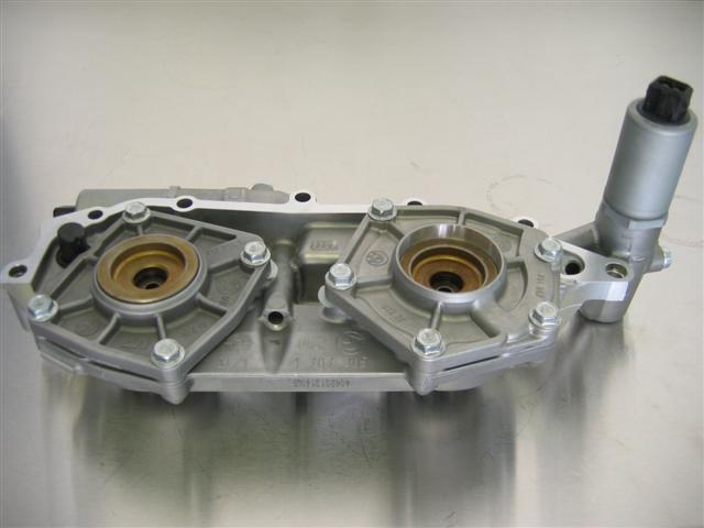

Failo aprašymas: Double vanos with splined shafts (cups) attached to pistons. Exhaust on left, intake on right. Note exhaust splined shaft is advanced (inserted) by default.
1.jpg [ 32.63 KiB | Peržiūrėta 14630 kartus(ų) ]
Failo aprašymas: Double vanos. Note advanced exhaust piston. Intake piston can move freely, but exhaust piston can only be retarded by powerful force.
2.jpg [ 32.51 KiB | Peržiūrėta 14647 kartus(ų) ]
Failo aprašymas: Double vanos with cylinder/piston covers removed. Spring behind exhaust piston fully advances piston by default. Two sets of seals on each piston facilitate dual oil compression chambers to control advancement (out) and retardation (in) of the pistons. Oil passage access at bottom of piston cylinder, and through cylinder cover, facilitate oil pressure control in two oil chambers.
3.jpg [ 39.17 KiB | Peržiūrėta 14659 kartus(ų) ]

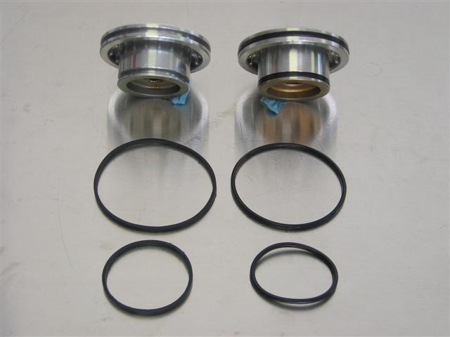

Failo aprašymas: Two pistons, right with seals installed, left with seals removed. Each seal set is made of two rings. The outer (left) is a Teflon seal and the inner (right) is an elastomer O-ring. Vanos exhaust and intake pistons and seals are same part components.
