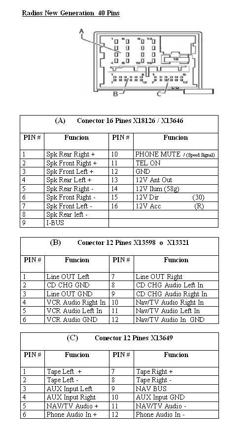

BM54(garso blokas):
http://i169.photobucket.com/albums/u201 ... 1249932641
http://img523.imageshack.us/img523/9620 ... xf3tg3.png
Pin No. / Wire Color / Function
Large Black Plug x18126
1 / Blue-Black / Right Rear + output to amp (twisted with 5 )
2 / Blue-Red / Right Front + output to amp (twisted with 6 )
3 / Yellow-Red / Left Front + output to amp (twisted with 7 )
4 / Yellow-Black / Left Rear + output to amp (twisted with 8 )
5 / Blue-Black / Right Rear + output to amp (twisted with 1 )
6 / Blue-Red / Right Front + output to amp (twisted with 2 )
7 / Yellow-Red / Left Front + output to amp (twisted with 3 )
8 / Yellow-Black / Left Rear + output to amp (twisted with 4 )
9 / White-Yellow bands / I-bus?
10 / White-Brown / Mute from phone?
11 / White-Green / ?
12 / Brown / Ground
13 / White / Remote on-off to amp
14 / Grey-Red / Dash illumination (dimmer)
15 / Red-Green / +12v from battery (not switched)
16 / Violet-White / +12v from ignition (ACC and RUN)
small white plug x13598
1 / / No function
2 / White-Brown / Audio common from 6CD player
3-7 / / No connection
8 / White-Red / Audio Left Channel from 6CD player
9 / White-Blue / Audio Right Channel from 6CD player
10 / / No Connection
11 / NAV / TV Audio +
12 / NAV / TV Audio -
NEW Small black plug: x13649 plug
1 / Tape left +
2 / Tape left -
3 / Left Connection for AUX Input
4 / Right Connection for AUX Input
5 / NAV / TV Audio +
6 / White-Black / Phone audio + Positive
7 / Tape right +
8 / Tape right -
9 / No connection
10 / AUX Input Ground
12 / Brown-Black / Phone Audio - Groundv
Line-out is BM54
http://www.treffseiten.de/bmw/bilder/sh ... 2.jpg&c=no

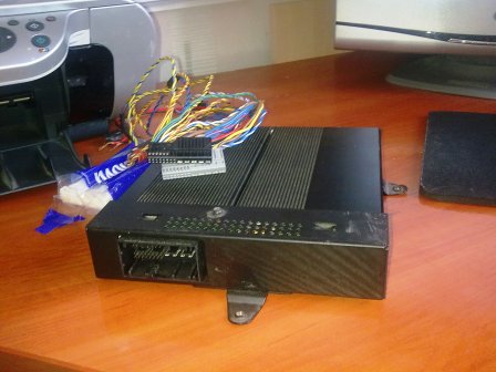

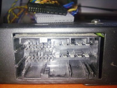

nekurent naujos temo . gavau ir as toki stiprintuva . dar ir as noreciau apsijungti ji ant savajo E34 . magelis Pioneer DEH-P80MP . ir nesuprantu i kuriuos pinus ijeina lineikos ar cia teisei mago isejimai ijeina i stipreka . su juo uzmaitinti noriu preikines ir galines kolonkes

prikelsiu sena tema ir paskutini klausima, kaip toki (harman kardon) stiprintuva pasijungti prie paprasto mago ir 10 HK koloneliu ?:)
jeigu gerai suprantu tai : i 5 reikia paduoti +12v, 26 kebulas, i 10 reikia +12v kad ijungti viska. o 30,29 ir 9,8 yra kaip line in ir nuo magiuko line out isejimu turi jungtis i stipr ?
beto jeigu viska gerai supratau tai dar klausimas ar pats stiprintuvas turi visus reikiamus kolonelem filtrus, ar pacios koloneles juos turi, ar butina tureti garso bloka is kurio jau iseina kur reikia susilpninti signalai i stipr ? jeigu trumpiau tai viska paprastai sujungi ir visos koloneles puikiai groja ir nesudega ar dar kazka burti ?
