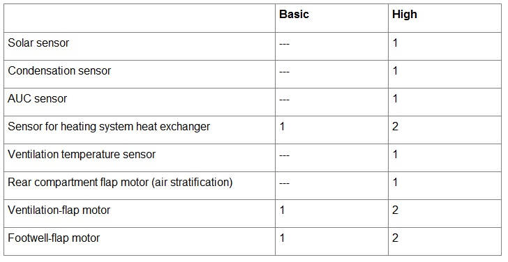

Integrated automatic heating / air-conditioning system (IHKA), Basic and High E60, E61, E63, E64
Introduction
The integrated automatic heating/air conditioning system (IHKA) is available in the versions Basic and High (option 534).
- E60 and E61
Standard equipment: IHKA Basic (IHKA High on 545i)
- E63 and E64
Standard equipment: IHKA High
The automatic air conditioning system High has separate ranges of adjustment for the driver' side and for the front-passenger side.
New features of the IHKA:
- An electric auxiliary heater working on the PTC principle (positive temperature coefficient) is installed on vehicles with diesel engines
The electric auxiliary heater is a component of the heat exchanger for the heating system. Electric heating elements made of aluminium have been added to the fins in the coolant flow of the heating system heat exchanger. The air drawn in is directly heated by these heating elements and fed into the vehicle interior through the air vents. In principle, the electric auxiliary heater works like an electric fan heater.
- Condensation sensor
The condensation sensor detects an imminent misting up of the windscreen, before condensation actually forms. To prevent the windows from misting over, the IHKA control unit starts to work through a table of measures as soon as a certain level of humidity is detected at the windscreen.
- LIN bus (Local Interconnect Network bus)
The LIN bus serves to actuate flap motors, the electric auxiliary heater and the blower motor in the heating/air-conditioning system.
- Convertible program (E64 only)
When the convertible top is opened and the air-conditioning system is in automatic mode, the convertible program is automatically activated.
The convertible program adapts the air-conditioner settings (blower, airflow, temperature) to the conditions created by the open top. The settings do not have to be changed when the top is opened or closed.
The convertible program is stored in the IHKA control unit.
Differences between IHKA Basic and IHKA High:
dif.jpg [ 29.17 KiB | Peržiūrėta 15433 kartus(ų) ]
Issamiau: http://www22.zippyshare.com/v/zQIdU4CA/file.html

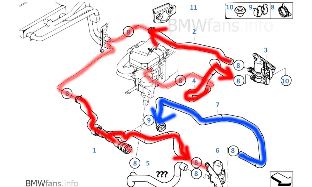

Buvau pas Vitaliju Kalotej, taip pat Autokurte.. niekas nenori apsiimti mano Webasto. Ir siaip jau beveik principo reikalas pasidare issiaiskinti paciam, pries vaziuojant i Krasta :)
Neuzvedus variklio greit pasiekia apie 200°C ir issijungia.
Esant uzvestam varikliui lyg ir veikia normaliai, neissijungineja. Webasto termo daviklis svyruoja apie 140°C, nors variklis dar tik ipusejes silti.
Apciupinejau slangas kurios isyla veikiant webastai neuzvedus variklio:
http://bmwfans.info/parts-catalog/E60/E ... ihka_basis
Untitled-1.jpg [ 65.17 KiB | Peržiūrėta 15321 kartus(ų) ]
Slangos nr. 4, 2 ir 1 siltos, nr. 7 saltas. Voztuvas nr. 6 ir slanga nr. 5 nepasiekiama, todel kas vyksta su jais - nezinau. Bet jeigu jau nr. 7 saltas, tai turbut voztuvas veikia ir srauta nukreipia teisinga linkme per slanga nr.5 atgal link webastos. O galbut gali buti taip, kad voztuvas nr. 6 uzsikirtes tokioje padetyje, kad nepraleistu antifryzo srauto nei i varikli, nei i webasta? Tada butu logiska, kad nors webasto pompa veikia, bet ji neturi ko pompuoti ir cirkuliacijos vistiek nesukuria. Ar gali taip buti?
Zodziu, itarimai tokie:
1. Webasto pompa - siaip klaidu bloke nera, todel esu linkes tiketi, kad ji veikia. Ar gali buti taip, kad ji is tikruju neveikia, nors ir nera klaidos?
2. Perjungimo voztuvas nr. 6 blokuoja antifryzo srauta
3. Temperaturos daviklis - jo rodomos temperaturos nelabai logiskos, bet Youtube teko matyti, kad kai zmonems jis neveikia, buna "uzstriges" ties viena rodoma temperatura, kuri nesikeicia, o pas mane ji keiciasi, nesoliuoja. Kazin ar nebus cia farenheitais pateikta, bet INPA rodo klaidinga matavimo vieneta..
