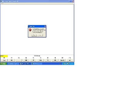

va koki errora meta
untitled.JPG [ 21.15 KiB | Peržiūrėta 64589 kartus(ų) ]
StandartinėParašytas: 19 Gru 2010, 17:49
2007.12.09
232
pas mane irgi toki errora ismeta, bet tik ant senesniu kebulu kaip E39 ar E38. kas cia galetu buti?
stai ka radau, variable nustatyta gerai
EDIABAS error: Error (95) SYS-0005: OBJECT FILE NOT FOUND
Reason 1: No SGBD in C:\EDIABAS\ECU
Solution 1: Copy the SGBD into the Ecu directory.
Reason 2: No group file in C:\EDIABAS\ECU (for group call)
Solution 2: Copy the group file to C:\EDIABAS\ECU
Reason 3: No path definition C:\EDIABAS\BIN
Solution 3: Set the system variable (see 2.1)
Reason 4: Incorrect path definition in EDIABAS.INI
Solution 4: Set the EcuPath path in Ediabas.ini to C:\EDIABAS\ECU
Reason 5: The SGBD name contains reserved characters or is too long. Only 8 characters
are allowed (a-z, A-Z, 0-9, "_").
beto cia ismeta kai atidarau programa neprisijungus prie auto, prisijungus nebandziau dar
