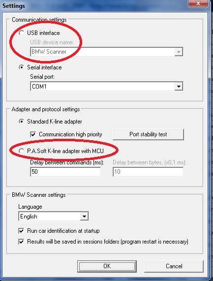

Demo scaneris eina per K-line, uztenka jam K-DCAN draivu,
O nustatymus pasijungimo paciam BMW Scanner pakeitei?? Pakaitaliok ir prisijungsi

Kai pajungiu pati BMW Scanner'i prie PC (Win 8.1) Device manager'is ji aptinka, tik draiverių neranda jam nei rankiniu būtu nei automatiškai.
Jei paleidžiu DEMO versiją tada iššoka tas langas kur galima pasirinkti pasijungimo būdą. Aceit pilnoje versijoje net iki jo nenusigaunu.

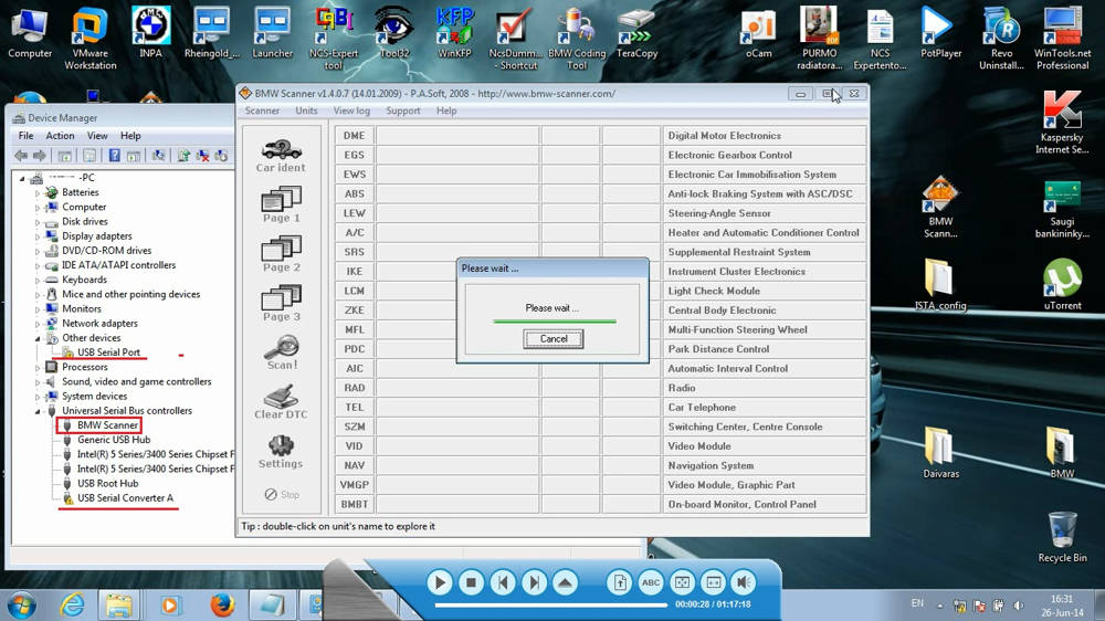

O tai tau pagal sita nesigavo?? man viskas gavosi pernai vasara
Cituoti:
Next you have to go to device manager:
1. Click start button, right click on computer and hit manage. (Sorry if you already know how to do this, just going step by step in case you dont)
2. Click on Device manager and scroll to Universal Serial Bus controller.
This is the weird part, I did it on two computes, for one of the computers this next step caused on of my usb ports to stop working, so its a gamble, however on my other computer nothing weird happened.
3. Next chose one of the USB Root Hubs and right click and then Update driver.
4. Then browse my computer for driver software
5. Choose let me pick from a list of device drivers
6. Then chose "Have Disk"
7. Browse to where you extracted the above file and select ftdibus and hit ok.
8. From the list I choose usb serial convert A and click install
9. Just click ok through all the prompts win7 throws your way.
10. Turn off your internet, then plug BMW scanner into car and then into computer. Win7 will say it cant install device
11. Go back to device manger and find BMWscanner that should have a yellow ! next to it. Right click, update driver and install the same driver you did for the first usb hub. It might error out. Open up BMWScanner software and it should know show up that drivers installed and connected to car!
Buvo keli sauktukai bet prisijunge ir veike, galim pabandyt gal ir ant Win8 x64 pakursiu

Bandžiau šį metodą du kartus, pirmame step'e sumeta draiverius, antrame (11 iš citatos) bandant juos dar kartą pritaikyti gaunu BSOD ir taip du kartus.
