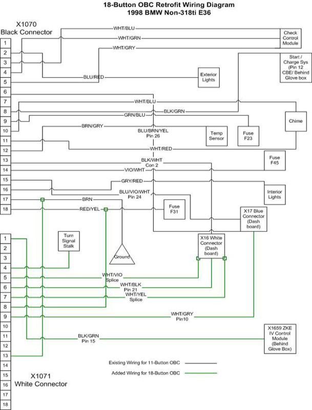

Įdedu OBC pajungimo schemą, iš 11 į 18 mygtukų, bei trumpą aprašymą.
Gal kam pravers. Pačiam teko ją išbandyti, pajungus viskas veikia puikiai.
Info ir pati schema paimta iš čia.
1. Remove old OBC, Steering Wheel, Instrument Cluster, and dashboard.
2. Remove the two connectors from the back of the Instrument Cluster.
3. Tap a fresh wire into the white/gray (WHT/GRY) wire on Pin 10 of connector X17 and run it to the white/gray wire coming out of Pin 9 of X1071.
4. Tap a fresh wire into the white/violet (WHT/VIO) wire on X16 and run it to the white/violet wire coming out of Pin 5 of X1071. Tap a fresh wire into the white/yellow (WHT/YEL) wire on X16 and run it to the white/yellow wire coming out of Pin 7 of X1071.
5. Remove the X16 connector cover to reveal the metal pins of the connector. You must figure out a way to install a new pin into the vacant Pin 21 slot. I went to the local BMW dealership and browsed their connector bins until I found a male pin connector that I could modify to work. I soldiered a fresh wire onto the pin and set the pin into the vacant Pin 21 slot in the X16 connector. I then ran this new wire to the white/black wire coming out of Pin 6 of X1071.
6. Find the ZKE IV Control Module behind the glove box. The Bentley manual will help you find it. Fabricate a pin to fit into the vacant Pin 15 of this connector. I fabricated this pin from a blue Butt Connector. Run a fresh wire from Pin 15 of the ZKE IV to the black/green (BLK/GRN) wire coming out of Pin 1 of X1071.
7. Install the turn signal stalk. Tap into the brown/red wire of the new turn signal stalk and run it to the brown/red wire of Pin 4 of X1071.
8. Tap into the brown (BRN) wire coming from Pin 17 of connector X1070 and run it to the brown wire of Pin 13 of X1071.
9. Tap into the red/yellow (RED/YEL) wire of Pin 18 of X1070 and run it to the red/yellow wire of Pin 8 of X1071.
White/Gray wire: connects OBC to speedometer sensor
White/Violet and White/Yellow wires: connects OBC to data link system. This system integrates most of the electronic boxes such as ABS, Cruise Control, EWS, ZKE, DME, OBC, etc.
White/black wire: connects OBC to gas gauge
Black/Green: connects OBC to AWS anti-theft device
Brown/Red: grounds OBC for turn signal stalk activated menu display
Brown: Ground
Red/Yellow: Power

bandau pasijungi 18 mygtuku obc, reikia pajungti is baltos obc fiskes i balta spidometro fiske laidus, bet pas mane jau yra spidometro fiskej tie pinai i kuriuos reikia jungti uzimti. Tai ka man juos nukirpti ir sujungti tiesiai su obc???? Ar tiesiog prie spidometro tu laidu ju nenukerpant dajungti tuos is obc baltos????
Pagal schema kur jungti tuos likusius obc baltos fiskes laidus pvz kaip exterior lights system.
Ar jus tiesiog palik nepajungtus?

Tai iš skydelio atitinkamos fyškės išeinantiems reikiamiems kontaktams padaryk Y tipo išsišakojimus ir pajungsi.

Ginchius rašė:
Ieskodamas ZKE IV (EWS II) moduli, nuemiau daiktadeze ir randu tucia
Paveikslėlis
Turetu buti cia
Paveikslėlis
Stovejo 11 OBC su Check Control, ar gali buti kad pas mane jo nera ? Ar iekot kitoje vietoje ?
StandartinėParašytas: 26 Geg 2011, 23:24
2008.04.29
1107
Radau info, jog ZKE IV ( EWS II ) pajungiamas E36se kurie ejo '95 - '98m.
X1071 Pin1 ---> X1659 Pin15 ( EWS II ) '95 - '98m
X1071 Pin1 ---> X55 Pin9 ( EWS I ) -----'94m
X1071 Pin1 ---> X222 black/violet ( DME ) '92 - '93m
Info is CIA
Mano yra '92m. Kaip suprantu X222 yra cia ?
Paveikslėlis
Vietoj vieno black/violet laido, radau du
Paveikslėlis
Bandziau pajungt ir prie vieno ir prie kito laido, CHECK neveikia. Gal kas turi kokiu minciu, ar yra pajunges OBC '92m ?
