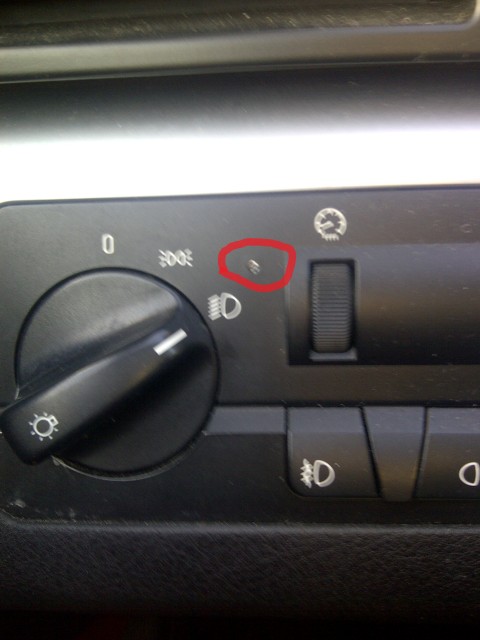

salia sviesu pasukimo knopkes kazkokia lempute. Kokia jos funkcija?
Failo aprašymas: lempute
IMG-20130125-00154 (Small).jpg [ 55.02 KiB | Peržiūrėta 6409 kartus(ų) ]

Zinau kad vienas sviesos daviklis yra salia klimos ekranelio esanciose grotelese. Gal cia dar vienas koks jutiklis.
http://forums.bimmerforums.com/forum/showthread.php?t=1356858
3. Interior Lighting
3.1. The light pattern on the test gauge shows an E46 3-series sedan
3.2. Pathway or "Follow Me" lighting is engaged by turning off car, taking keys from ignition, and then pulling back on the high beam stalk. Headlights will stay on about a minute after.
3.3. The dome lights can be disabled by holding down the main dome light switch for about 10 seconds. Holding the switch for the same amount of time will enable it again.
3.4. The red lights are more of a "filler" light for driving, and I wouldn't consider them part of dome lighting. I don't know how to disable them. They can be dimmed, however, but all the other dash lights will be dimmed at the same time.
3.5. The dimming option for Ms with navigations can be set from the 'Settings' menu on your navigation screen.
3.6. The nice thing the M3 does is turn off the lights before the battery dies if you leave the car door open.
3.7. At night when you have your lights on, the numbers on the shifter light up. (if you have a manual)
3.8. The sensor next to the headlight switch is for detecting lighting condition for the instrument and navigation, if you put your finger on the sensor at daylight, you will see it dimmed. Or if you put a flashlight and shine it during nighttime, it will be come brighter.

mariusgi rašė:
kaip tik cia sviesos daviklis, pagal kuri LCM reguliuoja ekranu apsvietimo lygi. Klimoj nera jokiu sviesos davikliu, yra tik temperaturos daviklis.

Spidometro ir kitu mygtuku apsvietimo jutiklis.

o aš išsamiau parašysiu: pagal šitą akutę galima susiprogramuoti kad trumpos įsijungtų kai sutemsta, arba įvažiuojat į kokią tamsią aikštelę. Tai pat ji reguliuoja OBC ir klimos apšvietimą, viskas.

Nzn bandziau as ji ten pridengineti nieko nereaguoja :) ir siaip kam tada tas mechaninis ratukas apsvietimo stiprumui reguliuoti jei tipo automatiskai turetu susireguliuoti

Kryzius rašė:
pamegink diena sumazinti ryskuma su ratuku, ir pamatysi kad ekranai nereaguos, o kai uzdengsi ta davikli tada prades temt.

diena sukinejant ratuka nereguoja tik klimos ekranas, na labai nedaug. bent jau pas mane.

mariusgi rašė:
tai del to ir nereguoja, daviklis juk mato kad yra sviesu, ir nereik temdyt. Kai uzdengi ta davikli, po keliu akimirku diena pradeda temt visi ekranai (odometro, klimos ir mago).
