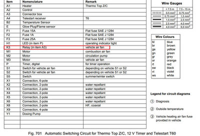

deivis E46 rašė:
Na rele reliai nelygi taip kaip ir webasta webastai, tai neaisku koke ten ardei jai be reles isijunge ir atsijunge :DD na su darbu ir davikliu(rele) pirkta krastome gavosi apie 200lt +- dabar tikslios kainos nepamenu;)
Speju apie tranzus kalbi, o ne apie reles ;) reliu tikrai E46 webastose nera

deivi, atsiprasau, bet webasto is tolo tik matei, meistro dirbtuvese gal ant stalo. ir mums cia jo mintis bandai papasakoti. bet gaunasi toks laaabai sugedes telefonas. kokia rele? nuotrauka surask paviesink. man atrodo tu valdymo bloka rele vadini.
skaityk: viewtopic.php?f=18&t=54470 , kai iveiksi 120 puslapiu, galesi mums porinti kada ir kaip isijungia kokios reles pagalba ir t.t. #-o

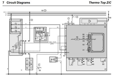

Nera ten jokiu reliu, isijungia tvarkinga webasta pati jei lauko temperatura apie +5*C , elektros schema siaip galetum pasiziuret.....
Cituoti:
Diesel
When starting the vehicle engine the heater goes in standby. With a water circuit temperature below 60 °C and an outside emperature below 5 °C (option with outside temperature sensor) the starting sequence commences.
The glow plug and the combustion air fan are activated. After 30 seconds the fuel dosing pump starts operation and combustion air fan operation is suspended for 3 seconds. Subsequently the combustion air fan speed is increased in two ramps within 56 seconds to nearly full load operation. After a stabilisation phase (constant speed) of 15 seconds the combustion air fan speed is again increased in a ramp within 50 seconds to nearly full load.
After reaching full load fuel delivery the glow plug is deactivated and the combustion air fan operation increased to full load.
During the subsequent 45 seconds as well as in normal operation the glow plug functions as flame sensor to monitor the flame condition.
After all these events the automatically controlled heating operation starts. In case of a no flame condition or a flameout, a restart is automatically initiated. If the no flame condition persists, fuel delivery is stopped and the heater enters an error lockout with a run-down of the combustion air fan.
A flameout during normal combustion operation causes an automatic restart.
Heating operation for the Diesel type heater is identical in the sequence of events. Should the coolant temperature drop during the control idle period to but not below 71 °C within 900 seconds, a subsequent drop in the coolant temperature below 71 °C causes the heater to perform a regular starting sequence into full load operation.
A drop in the coolant temperature during part load operation due to an increased demand in heat will cause the heater to switch to full load operation at 65 °C.

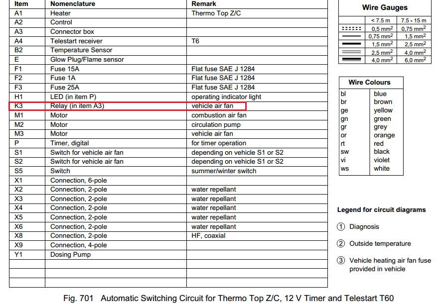

StandartinėParašytas: 14 Sau 2015, 23:06
2015.01.14
32
E46
na o čia?
Failo aprašymas: se detale tikriausiai prarijo arklys atbeges is lauku, skaitytojai jus skitytojai as galiu partasyt kad karve skraido paskaitrysit toke nesam patys netureja jokios patirties ir irodinesit nesamones ;)

deivis E46 rašė:
na o čia?
o kas cia? bb z kas ir is kur. ipakavimas gerai matosi, daugiau nieko. kur stovi sitas daiktas?
StandartinėParašytas: 14 Sau 2015, 23:37
Tai gal salono ventiliatoriaus rele, bet ne webastos, koks detales numeris??

:lol: :mrgreen:
kaip jau mineta viskas su tavim aisku, palinksminai, dekui.
webasto jam kaip siurbliukas dirba, temperaturos daviklis duoda signala, rele uztrumpina kontaktus ir vualia - webasto dirba =D>
meistras irgi geras, uz rele kurios nera pinigus paeme, ir dar paaiskno kas ir kaip.
viskas, labanakt.
ps. ten nuoroda esu daves, neskaitei aisku. ten nuotrauka yra, kaip smegenys atrodo. nera ten reles. o ir aplamai jos webastai nera. skaityk wds (tik kad tu nezinai kas tai)
