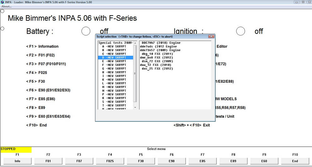

Kas naudojat INPA 5.0.6+F serija, ten galima papildomai pajungti daugiau kaip 200 IPO failiuku skirtu diagnostikai arba pagal savo POREIKIUS issirinkti reikiamus ir redaguoti SONDER.ENG failiuka

Cituoti:
But few people know also that the latest INPA 5.06 is more than 200 files IPO that are not listed in the menu INPY Fxx
and are located in the folder INPA / SGDAT
mainly to the F-series and the latest Exx
you can add yourself
EC-APPS folder / INPA / CFGDAT / INPA as in the photo, enter the number 19
F17 = E85
F17_Text = E85 (E86)
F17_ARCHIV = SGBD_E85
F18 = BMW_ALT
F18_KNOPF = OLD
F18_TEXT = OLD BMW MODELS
F18_ARCHIV = SGBD_BMW
F19 = Sonder
F19_KNOPF = Special
F19_TEXT = Special tests / Unit
F19_ARCHIV = SGBD_SONDER
Cituoti:
//* Nacharbeitsauswahl INPA
//* Datei SONDER.ENG
//* Drexel TI-430
//* History:
//* NEW SKRYPT 2007-2008
//* NEW SKRYPT 2009-2013
[ROOT]
DESCRIPTION=Special tests 2009-2013 skrypt
[ROOT_1]
DESCRIPTION=A -NEW SKRYPT
ENTRY=s_smg2na,SMG Adaption for sequential M-Gearbox,
ENTRY=s_gs30na,SSG Adaption for sequential Gearbox,
ENTRY=,,
ENTRY= s_lkm,Coding station for Rolls Royce air conditioning air flap module,
ENTRY=,,
ENTRY=s_funk_i,MDA Remote adapter initialisation,
ENTRY=,,
ENTRY=aag_f15, aag_f15 FXX (2012),
ENTRY= ahm_01,ahm_01 FXX (2012) body ,
ENTRY= ahm_70,ahm_70 (2010) body E89X E70 E60 E65,
ENTRY= amptlr13,amptlr13 FXX (2011) Communication Systems FXX,
ENTRY= amptuds,amptuds13 (2009) Communication Systems FXX EXX ,
ENTRY= amphhb20,amphhb20 FXX(2012) ,
ENTRY= asd, asd FXX (2011) FXX ,
ENTRY= autdsc1,autdsc1 EXX Automatic selection (2010) Hamulce EXX DSC 56 60 65 87 DXC70 90,
ENTRY= autdsc2,autdsc2 FXX Automatic selection (2011) FXX RR4 DSC_01 10 DXC25,
ENTRY= AUTEGS1,AUTEGS1 EXX Automatic selection (2009) EXX EGS SMG_60 DKG90 TCM72 GS19 ,
ENTRY= AUTEGS2,AUTEGS2 FXX Automatic selection (2010)FXX RR4 GWS_1,
ENTRY= AUTGWS1,AUTGWS1 EXX Automatic selection (2009)EXX GWS_60 GWS _70 GWS_90,
ENTRY= autemal2,autemal2 FXX Automatic selection (2011)FXX RR4 EMA_LI ,
ENTRY= autemar2,autemar FXX Automatic selection FXX (2011) RR4 EMA_RE,
ENTRY= auteme2,auteme2 FXX Automatic selection FXX (2010) EME_04 EME_10,
ENTRY= autemf2,autemf2 FXX Automatic selection FXX (2009) EMF_01 EMF_10,
ENTRY= auteps2,auteps2 FXX Automatic selection FXX (2009) EPS_10 EPS_01 EPS_20 EPS_25 ,
ENTRY= autfzd2,autfzd2 FXX Automatic selection FXX (2009) FSD3 FZD_20,
ENTRY= AUTGWS1,AUTGWS1 EXX Automatic selection EXX (2009) GWS_60 GWS _70 GWS_90,
ENTRY= AUTGWS2,AUTGWS2 FXX Automatic selection FXX (2011) GS100A GSB231 DKG10,
ENTRY= authkl2,authkl2 FXX Automatic selection FXX (2010) RR4 HKFM11 HKL_01,
ENTRY= auticm2,auticm2 FXX Automatic selection fxx RR4 (2008) ICMQL ICM_25
ENTRY= autihka2,autihka2 FXX Automatic selection FXX (2010) RR4 IHKA01 IHKA20 IHKA25,
ENTRY= autkomb2,autkomb2 Automatic selection (2010) KOMB01 KOMB25,
ENTRY= AUTLMV2,AUTLMV2 FXX Automatic selection (2008) LMV_01,
ENTRY= autkafa2,autkafa2 FXX Automatic selection FXX (2011)RR4 KAFAS01 KAFAS20,
ENTRY= autvgsg1, autvgsg1 EXX Automatic selection EXX (2009) VGSG70 VGSG90 VGSG83 VGSG84,
ENTRY= autmot1,automot1 EXX FXX Automatic selection EXX FXX(2011) ,
ENTRY= autsme2, autsme2 FXX Automatic selection FXX (2010) SME_04 SME_10,
ENTRY=,,
ENTRY= AUTLW,AUTLW Automatic selection EXX MMC_07 MMCH70 CDCH70 CDC_46,
ENTRY= AUTMCGW,AUTMCGW Automatic selection MASK2_GW RAD2_GW CICR,
ENTRY= auticm2, auticm2 Automatic selection,
ENTRY= AUTMMC, AUTMMC Automatic selection EXX MMC_65 MM CH70 ,
ENTRY= autnav, autnav Automatic selection EXX E60 CICM CICR CCCA60 NAVL60,
ENTRY= AUTLMV2, AUTLMV2 Automatic selection FXX LMV_01,
ENTRY= autrdc,autrdc Automatic selection (2008) rdc_1 rdc_60 RDC_53,
ENTRY= asa_71, asa_71 Active Steering,
[ROOT_2]
DESCRIPTION=B -NEW SKRYPT
ENTRY= bpcm72,bpcm72 (2009) E70 EXX,
ENTRY= bdc, bdc (2012) FXX BODY Domain Controller BDC ,
ENTRY=,,
[ROOT_3]
DESCRIPTION=C -NEW SKRYPT
ENTRY= cdm_rr4,cdm_rr4 RR4,
ENTRY= Cgw_rrs2, Cgw_rrs2 RR4 (2012),
ENTRY= cmedia, cmedia (2009) ,
ENTRY= ctm_89, ctm_89 (2009') CVM,
ENTRY= cvm_12,cvm_12 (2010) CVM,
ENTRY=,,
ENTRY= cvm_88, cvm_88,
ENTRY= cvm_r57,ccm_r57,
ENTRY= CFG-PL2_20070823, CFG-PL2_20070823,
[ROOT_4]
DESCRIPTION=D -NEW SKRYPT
ENTRY= DDE7N47, DDE7N47 (2010) Engine,
ENTRY= dde7uds,dde7uds (2012 Engine,
ENTRY= dde73n57,dde73n57 (2009) Engine,
ENTRY= dkg_10, dkg_10 FXX (2011),
ENTRY= dme_bx8,dme_bx8 FXX (2012) ,
ENTRY= dsm_72, dsm_72 EXX (2009),
ENTRY= dwa_12,dwa_12 FXX (2010),
ENTRY= dxc_25, dxc_25 FXX (2012),
ENTRY=,,
[ROOT_5]
DESCRIPTION=E -NEW SKRYPT
ENTRY= ehc_01, ehc_01 FXX (2011) ELECTRONIC RIDE-HEIGHT CONTROL (EHC) fxx,
ENTRY= ehc2rr4, ehc2rr4 RR4 (2009)ELECTRONIC RIDE-HEIGHT CONTROL (EHC)rr,
ENTRY= ekk_72, ekk_72 EXX (2009),
ENTRY= eme_04, eme_04 FXX (2010),
ENTRY= eme_10, eme_10 FXX (2012) ,
ENTRY= emf_10, emf_10 FXX (2010) chassis E65 Electromechanical Parking Brake,
ENTRY= Energiediagnose_L6_V111,Energiediagnose_L6_V111 (2009),
ENTRY= eps_01, eps_01 FXX (2010) chassis EPS EPS Electric Power Steering,
ENTRY= eps_72, eps_72 (2009) chassis EPS Electric Power Steering,
ENTRY= ETC, ETC FXX(2012) ,
ENTRY=,,
ENTRY= ECF_E65, ECF_E65,
ENTRY= EDC_K, EDC_K,
ENTRY= empi72, empi72,
ENTRY= ekp360, ekp360 ,
ENTRY=E46,E46 TEST IDENT Functional jobs ,
ENTRY=E83,E83 X3 TEST IDENT Functional jobs ,
ENTRY=e53,e53 X5 TEST IDENT Functional jobs ,
[ROOT_6] -NEV SKRYPT
DESCRIPTION=F -NEW SKRYPT
ENTRY= fla_01, fla_01 FXX(2011) HIGH BEAM ASSIST (FLA) BODY,
ENTRY= fla_20, fla_20 FXX (2011) FXX BODY HIGH BEAM ASSIST (FLA),
ENTRY= fle_l, fle_l (2012) FXX,
ENTRY= fle_r, fle_r (2012) FXX,
ENTRY= frr_10, frr_10 (2009) FXX F10 ?,
ENTRY= frr_70, frr_70 EXX (2011) E70 ?,
ENTRY= fzd_20, fzd_20 FXX (2012) BODY FUNCTION CENTRE, ROOF (FZD),
ENTRY=,,
[ROOT_7]
DESCRIPTION=G -NEW SKRYPT
ENTRY= gen_most, gen_most FXX (2009) ,
ENTRY= ghas10, ghas10 FXX (2010) ,
ENTRY= gkehy23, gkehy23 FXX (2012) ,
ENTRY= gsb231, gsb231 FXX (2011),
ENTRY= GSB231_ea, GSB231_ea FXX (2009) ,
ENTRY= gsb233, gsb233 FXX (2012),
ENTRY= gws2, gws2 EXX (2011) GWS_70 Gangwahlschalter,
ENTRY= gzar01, gzar01 FXX (2012 ,
ENTRY=,,
ENTRY= gw_rr4, gw_rr4,
ENTRY= gws_90, gws_90 selektor seitch GEAR BODY,
ENTRY= GS19d_EA, GS19d_EA SKRZYNIA AUT,
[ROOT_8]
DESCRIPTION=H -NEW SKRYPT
ENTRY= hc2_01, hc2_01 FXX (2012) ,
ENTRY= hcp_72, hcp_72 EXX (2009) e70 ?,
ENTRY= him_72, him_72 EXX (2009) e70 ? ,
ENTRY= hkfm11, hkfm11 (2010) FXX ,
ENTRY=,,
ENTRY=,,
ENTRY= hkl_70, hkl_70 ,
[ROOT_9]
DESCRIPTION=I -NEW SKRYPT
ENTRY= icam_f15, icam_f15 (2012 FXX chassis),
ENTRY= ihka25, ihka25 (2009) FXX klimatyzacja BODY,
ENTRY= ihka_f15, ihka_f15 (2011) FXX Klima,
ENTRY= ihkarr4, ihkarr4 (2011) RR4 klima BODY,
ENTRY=,,
ENTRY=,,
ENTRY= ICM_71, ICM_71 DYNAMIK MANGAMENT CHASIS,
ENTRY= IHKA46, IHKA46 KLIMA,
[ROOT_10]
DESCRIPTION=K -NEW SKRYPT
ENTRY= kafas70, kafas70 (2009) BODY KAFAS01,Drive assistence/ Camera based KAFAS,,
ENTRY= komb25, komb25 FXX (2010)Instrument Clustler BODY,
ENTRY=,,
[ROOT_11]
DESCRIPTION=L -NEW SKRYPT
ENTRY= ldm_70, ldm_70 EXX (2010) Dynamic Management/Longitudinal LDM,
ENTRY= lhm2_l, lhm2_l (2011) FXX ,
ENTRY= lhm2_r, lhm2_r (2011) FXX ,
ENTRY= lmv_01, lmv_01 (2009) FXX,
ENTRY= lmv_84, lmv_84 (2009) X1,
ENTRY=,,
ENTRY=,,
ENTRY= lmvr60, lmvr60,
ENTRY= lm_ahl_2, lm_ahl_2 ,
[ROOT_12]
DESCRIPTION=M -NEW SKRYPT
ENTRY= mcpa72, mcpa72 EXX (2009) e70 ?,
ENTRY= mcpb72, mcpb72 EXX (2009) e70 ?,
ENTRY= me17r4, me17r4 (2010) engine,
ENTRY= MED17_2, MED17_2 (2009) engine,
ENTRY= MEVD17KW, MEVD17KW (2012) engine,
ENTRY= mevd172, mevd172 (2012 engine,
ENTRY= mevd172_alt, mevd172_alt (2009) engine ,
ENTRY= mevd174k,mevd174k (2012) engine,
ENTRY= mevd176k, mevd176k (2012) engine,
ENTRY= mevd1724, mevd1724 (2012) engine,
ENTRY= mevd1725, mevd1725 (2012) engine,
ENTRY=,,
ENTRY= mmc_uds, mmc_uds (2009) Communication Systems Changer / Multimedia-Changer,
ENTRY= msd80-german, msd80-german (2012) engine,
ENTRY= msd80n43, msd80n43 (2010) engine,
ENTRY= MSD85, MSD85 (2012) engine,
ENTRY= MSD85L6, MSD85L6 (2012) engine,
ENTRY= msd87_12, msd87_12 (2012) engine,
ENTRY= mv1722, mv1722 (2010),
ENTRY= mvd1722, mvd1722, (2012) engine,
ENTRY= mvd1746k, mvd1746k (2011) engine,
ENTRY= mvd17245, mvd17245 (2011) engine,
ENTRY= M_ULF, M_ULF (20..)TELEPHONE - HANDS FREE (ULF),
ENTRY=,,
ENTRY= MASK2_GW, MASK2_GW MOST CAN NAVI ,
ENTRY=,,
ENTRY=,,
ENTRY= MEx17_2N, MEx17_2N engine,
ENTRY= ME9_N62, ME9_N62 engine,
ENTRY= mmb2rr, mmb2rr,
ENTRY= mriabs3, mriabs3,
ENTRY= mrfzg, mrfzg,
ENTRY= mrabs2, mrabs2,
ENTRY= mrbmsc2, mrbmsc2,
ENTRY= mrkmsk16, mrkmsk16,
ENTRY= msd87_r0, msd87_r0 engine,
ENTRY= msd87_l0, msd87_l0 engine,
[ROOT_13]
DESCRIPTION=N -NEW SKRYPT
ENTRY= n47t, n47t (2010) engine diesel,
ENTRY= n47tuds, n47tuds (2009) engine diesel,
ENTRY= n63tu, n63tu (2012) engine ,
ENTRY= nivi2, nivi2 (2012) Communication Systems ,
ENTRY=,,
[ROOT_14]
DESCRIPTION=P -NEW SKRYPT
ENTRY= pma_20, pma_20 FXX(2012) ,
ENTRY= pma_10, pma_10 FXX (2010),
ENTRY= pcu_f15, pcu_f15 FXX(2012),
ENTRY= pdc_01, pdc_01 FXX (2012) PARK DISTANCE CONTROL (PDC),
ENTRY=,,
ENTRY= pcu_10, pcu_10,
[ROOT_15]
DESCRIPTION=R -NEW SKRYPT
ENTRY= radioe39, radioe39 EXX(2012) ,
ENTRY= radioe46, radioe46 EXX (2012) ,
ENTRY= rdc_gen3, rdc_gen3 FXX (2011) RDC,
ENTRY= rdc_01, rdc_01 FXX(2009) RDC,
ENTRY= rema_li, rema_li FXX (2011) ,
ENTRY= rema_re, rema_re FXX (2011),
