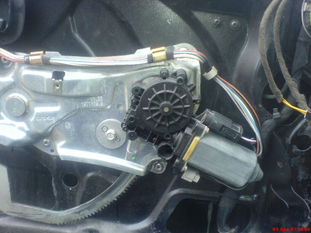

Db galvoju apie ta magnetuka, pas mane naujesnis lango mechanizmas, ar tas magnetukas yra ir jame ar tik tame senesniame, imesiu foto jei supranti kurioj vietoj jis, papasakok trumpai:
motoriukas.JPG [ 45.82 KiB | Peržiūrėta 3191 kartus(ų) ]

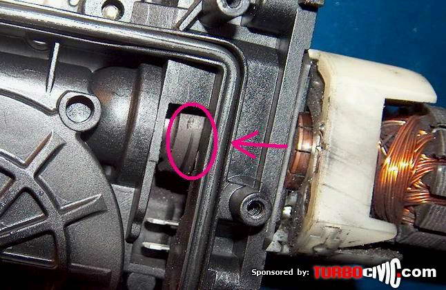

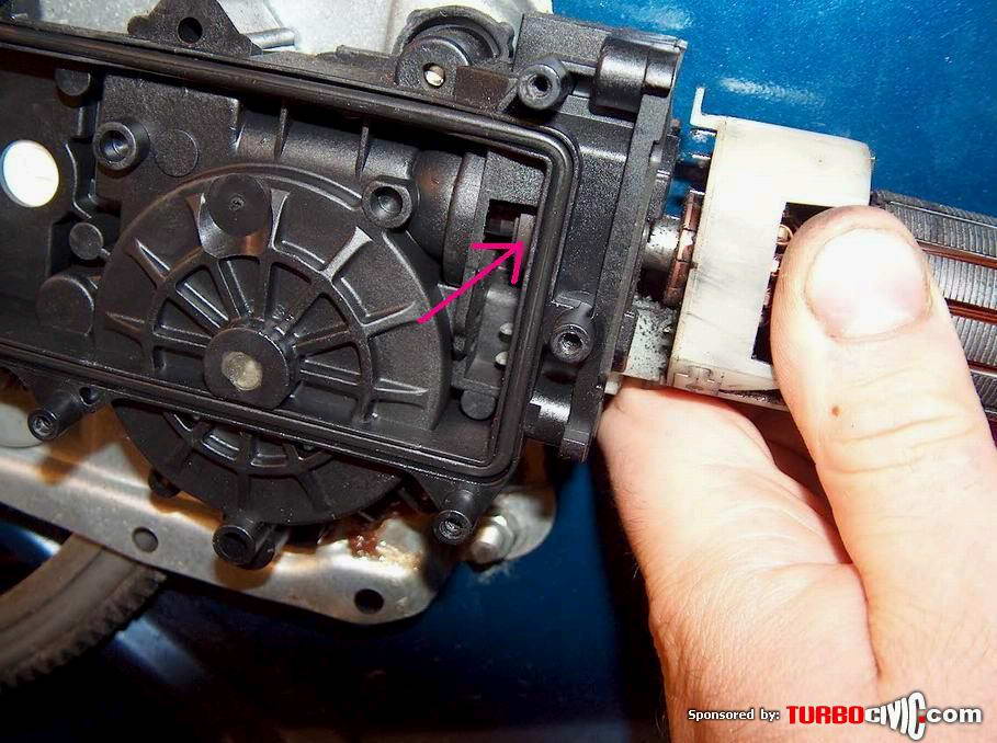

Ištrauka angliškai:
Cituoti:
famous window problem:
many people have window problems with E36 when their windows roll up or down by half an inch at one time.
the window motor has motion sensor inside which takes info from magnetic ring that is on motor shaft. for some reason this ring dislocates and sensor gets no info so motor drive circuit thinks its stuck.
all you have to do is to open motor and relocate this ring. on sedan it can be done without taking window mechanism apart ( and drill rivets) on coupe you have to take mechanism on table.
magnet ring is marked red and red arrow points toward its place where its have to be
Šaltinis: http://forums.bimmerforums.com/forum/sh ... p?t=238468

Ankschiau keichiau langu mechanizma, tai liko senas - neveikiantis (kalbu apie ta naujesni mechanizma) pabandzhiau ji ishardyti, varikliukas atsisuka ish kitos puses mechanizmo ( jei tektu ardyt mechanizma esanti durelese, tai varikliuka ishardyti be shansu kol nenuimsi pachio mechanizmo) nusiimu ash ta varikliuka, ji ishardau, nerandu nieko panashaus i ta magnetuka kuris pavaizduotas senam mechanizme (BMW E36 iki 94m). Atsukus pati varikliuka nuo mechanizmo, matosi metalinis dantratis, kuris valdo visa mechanizma, po to nuo pachio varikliuko nuemus plokshchia skardele (dangteli), viduje yra plastmasinis dantratis plokshchias apvalus, ji varineja metalinis dantratis (panashus i varzhta tik su didesniu sriegiu). Zhiurint ish priekio i pati varikliuka toje plastmasineje dalyje yra padaryta tushchia nedidele anga, ji uzhdengta apsauga, ja atidengus matosi nedidelis tarpelis, ten ko gero padaryta pachiam varikliukui sutept alyva ar kazhkas panashaus. Apart to ka ash chia prirashiau daugiau nieko doro ten neradau :wink:
Tas variantas, kad kaltas magnetukas, ko gero atkrenta. Sakychiau, kad strigtu pats mechanizmas atidarant - uzhdarant langa, tada daugmazh butu aishq kur problema. Vis del to dar karta surizikuosiu ir pasikeisiu ZKE IV moduli, radau zhmogu kuris parduoda ji nuo coupe.
Kai tik bus kokiu naujienu praneshiu :wink:
